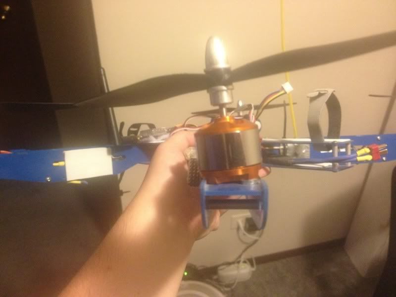

THe typical V-tail, with the motors point AWAY from each other, is done so that their prop wash doesn't mix and cause bad JOO-JOO. With the HTFPV, the motors are so far apart, that isn't a problem. Basically, look down your rear left arm, from motor to FC. You want the washers on the two motor bolts to the RIGHT of the arm, so the motor is pointing to the LEFT of the arm, which is basically forward.
Posted Image
Posted Image
Like that. After this and the yaw mix adjustment, my quad had no problems with yaw authority.

Yeah, inwards-pointing versus outwards-thrusting... the semantics get odd (MixMaster Mat is always my default reference point).
Thanks for the pics and such, that clears up the differences. I'll try it.

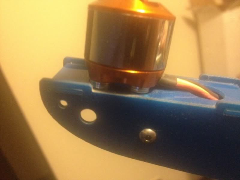

Posted Image
Do you fly without that far spacer screwed in? My HT-FPV has more Jello than Bill Cosby. Without those spacers holding that motor plate tight, it would be worse. I had to even super glue a couple of them due to play. Also, this is a protype frame right? ...before the arms had more spacers in'em?
Might try this v-tail trick.. thanks for all the testing you've done!
